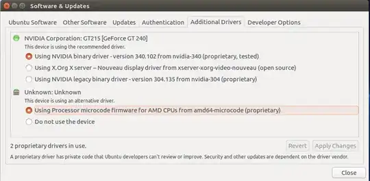

SOLVED after 7 months of HELL
goto "synaptic-settings-repositories-additional drivers" see if you have a "Unknown Unknown" radio button if you have then select it as i have in picture ,two weeks not one freeze.
