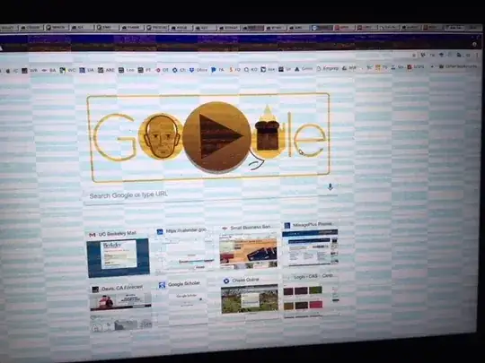

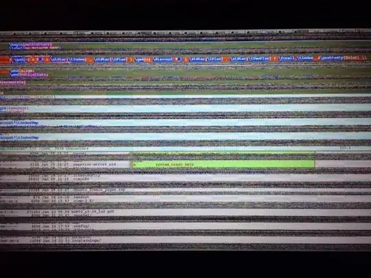

  • Often but not always, the screen looks something like this:
  • Or this:
Which seems to suggest a video driver problem. The only significant hardware change I've made in the last few weeks is to add a nvidia driver. Suspecting this to be the culprit, I purged the driver, but the problem continues.

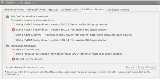

This site suggests going to Software and updates -> Additional drivers, looking for Unknown-Unknowns and checking "Using Processor Microcode" Here's the page that I see:
When I click on "Using Processor Microcode" the change doesn't take affect, the gui reverts to the above displayed screen.
