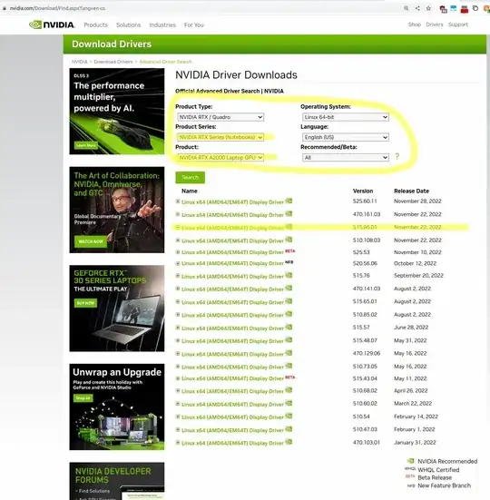

How to find an NVIDIA driver which works with your brightness function buttons
Solved! Many of NVIDIA's video drivers on Linux have regressions, breaking screen brightness control in later driver versions, so you should install the latest NVIDIA driver first, and then if your screen brightness control doesn't automatically work after rebooting (without any of the other fixes on this page), then progressively install older and older NVIDIA driver versions straight from the manufacturer until one naturally works with your screen brightness control function buttons.
Tested on a Lenovo ThinkPad P15 Gen 2 laptop with these specs: NVIDIA RTX A2000 4GB GDDR6 graphics card and Intel Core i9-11950H processor (8 cores/16 threads), in Ubuntu 22.04.
First, what does not work
I tried nearly every answer to this entire question, including modifying the /etc/default/grub file, the /usr/share/X11/xorg.conf.d/10-nvidia-brightness.conf file, and the /etc/X11/xorg.conf file, as well as writing directly to the /sys/class/backlight/nvidia_0/brightness file via echo 100 > /sys/class/backlight/nvidia_0/brightness, for instance. I tried these settings while booting with both the X11 video server/window manager, as well as Wayland. It made no difference. None of these "fixes" worked.
I also tried other fixes from other sites and forums. For my laptop and the NVIDIA 525.60.11 Linux graphics driver, none of those other solutions worked!
Again, I got the same results with both Wayland and X.
This really helpful post from @adrianer84 is what gave me the idea to try older and older driver versions until one worked. He said:
I can confirm, that
GRUB_CMDLINE_LINUX_DEFAULT="quiet splash nvidia.NVreg_RegistryDwords=EnableBrightnessControl=1"
on Ubuntu 22.04 and GeForce RTX 3600 mobile with the 470.XX.XX driver works on a Legion 7 (2021) (16ACHg6) for controlling the backlight - while it does not with 515.XX or 520.56.06 (with 520.56.06 there is even one more regression: the backlight is completely off after sleep - so the display is basically off. As you cannot control it, you have to force-reboot…).
What does work but which I do not recommend you do
Your BIOS/UEFI probably supports (it should) setting your graphics mode between "Hybrid Graphics" and "Discrete Graphics". NVIDIA says you must use "Discrete Graphics" mode to be compatible with their driver. However, if you set your mode to "Hybrid Graphics", it does make your brightness buttons work again because then your internal graphics card built into the CPU will handle that, but then again your NVIDIA graphics driver will also be glitchy and you may notice problems, and NVIDIA says to use "Discrete" mode.
So, boot into your BIOS/UEFI and change your settings to "Discrete Graphics" mode:
The meaning my UEFI tells me is (emphasis added):
  • Discrete Graphics mode will achieve higher graphics performance.
  • Hybrid Graphics mode runs as Integrated Graphics mode to achieve longer battery life, and Discrete Graphics is enabled on demand.
That tells me that the internal integrated graphics card built into the CPU chip is more-efficient, and the NVIDIA card is the external "Discrete Graphics" card.
NVIDIA says to use "Discrete Graphics" only, however, under the "Additional Information" tab of their download links, such as here for 515.86.01, for instance: https://www.nvidia.com/download/driverResults.aspx/194662/en-us/ (emphasis added):
Some designs incorporating supported GPUs may not be compatible with the NVIDIA Linux driver: in particular, notebook and all-in-one desktop designs with switchable (hybrid) or Optimus graphics will not work if means to disable the integrated graphics in hardware are not available.
Installing a slightly older driver version (515.86.01 instead of 525.60.11, in my case) did work!
What did work, however, was installing the NVIDIA 515.86.01 driver instead, which was the previous version in the "500" version series in the list, as shown here with these search parameters: https://www.nvidia.com/Download/Find.aspx?lang=en-us:
So, the solution is to follow Option 2 in my detailed NVIDIA graphics driver installation instructions here: How to install the proper NVIDIA graphics driver to hopefully prevent freezes.
Start by installing the latest NVIDIA driver for your graphics card. Then, reboot, log in, and try your brightness function keys. If they work, you're done! If they don't, go to the NVIDIA "Advanced Driver Search" page and install the next-oldest driver down the list in your driver version series, possibly skipping "Beta" and "NFB" (whatever that means) versions, until one works.
So, to make the point and demonstrate the order in which I'd try the drivers, if I was doing this based on the driver list in the image just above, I'd try the driver versions in this order (probably sticking to the later 500 series versions unless they all failed to work too):
  1. 525.60.11 - brightness buttons don't work for me!
  2. [optionally skip the 470.161.03 one since it's an older version series]
  3. 515.86.01 - brightness buttons do work for me!
  4. 510.108.03
  5. [optionally skip 525.53 since it's a Beta release]
  6. [optionally skip 520.56.06 since it's an NFB release--whatever that means]
  7. 515.76
  8. [optionally skip 470.141.03 since it's an older version series]
  9. 515.65.01
  10. etc.
Please report in the comments your laptop, graphics card, and which driver versions do or don't work for you to have brightness control via your function buttons.
