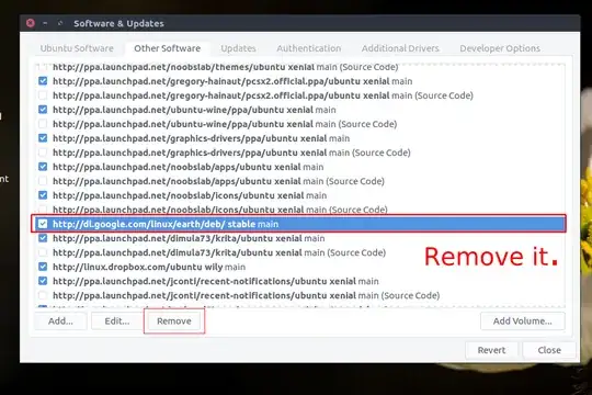

To avoid this error, you can remove the repository.
Please note that removing the repository will prevent Chrome from getting any updates, including important security updates!
This will make your browser vulnerable to an increasing number of threats over time!
If you really want to entirely remove or disable the repository, you should consider uninstalling Chrome and moving on to a different browser, like its open-source variant chromium.
This note was added by ByteCommander.
At first search for Software and Updates in the Dash. Open it and switch to the Other Software tab.
In there look for an entry like this one:
http://dl.google.com/linux/earth/deb/dists/stable/
and remove it.
Finally go to the Authentication tab and you will find something mentioning "Google", remove that too.
It should stop showing that annoying error message every time you try to update your repositories now.
