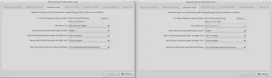

Currently the machine "runs fine" (without knowing what hasn't been executed during the upgrade). The noticeable difference to the working machine right now is, that the update notification doesn't appear anymore. In the settings, the subscriber type is greyed out and reads "Custom".
Comparison settings of update notifications

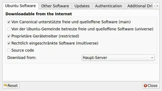

For the warning for weak key please follow here
Then please run sudo -H software-properties-gtk und change to main server for download. Tab (ubuntu software). Sorry german text.
Make sure you have enough space free (especially if you have own boot filesystem) If you have unfree drivers like nvidia or others control with
dkms status
If dkms is working.
software
sudo apt update && sudo apt full-upgrade
