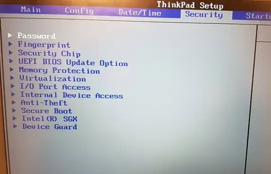

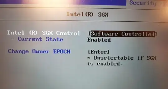

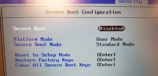

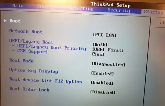

In the end the solution I think should be in some BIOS setting or reinstalling the driver (maybe from here?)

enter image description here enter image description here enter image description here enter image description here
Even from another distro, Fedora live, I have the same error. So I think or is something about the BIOS or the wifi card was damaged in some way..

This happened to me one time. It turns out I disabled Intel Platform Trust Technology in BIOS. Making sure that was enabled fixed my issue.
