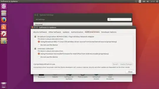

I work with a Lenovo B580 and Ubuntu 16.04. My device doesn't find W-Lan anymore (used to up until 2 weeks ago). I use this wlan device and drivers. Any suggestions for help?

Did you try checking the blacklist.conf file in the folder /etc/modprobe.d ?? Sometimes my wifi seems useless on various computers/ubuntu versions. Usually putting a # in front of the next ones solves the problem for me.
blacklist eth1394 blacklist bcm43xx
( Yes, you need to ben root to do this of course :-)
