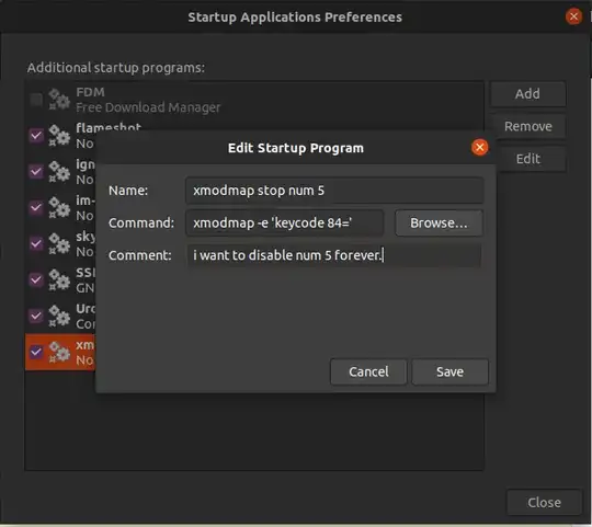

Go to Startup Applications and make a new entry with the content shown in the following screenshot:
adding new startup application(command)
It works every time.
