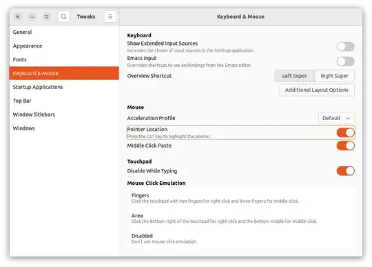

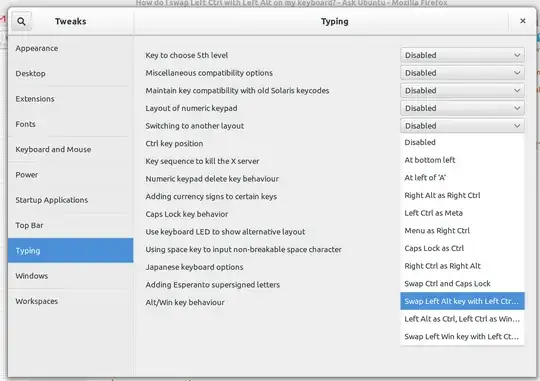

If you don't want to get into the pain of xmodmap, you can also do it through Gnome settings:
  • Install gnome-tweaks with sudo apt-get install gnome-tweaks
  • Open it
  • Go to Keyboard & Mouse -> Additional Layout Options
  • Change the Ctrl position option to Swap Left Alt with Left Ctrl:
Gnome Tweaks screenshot
You could probably also do this via gsettings, but am not sure of the exact config entry name.

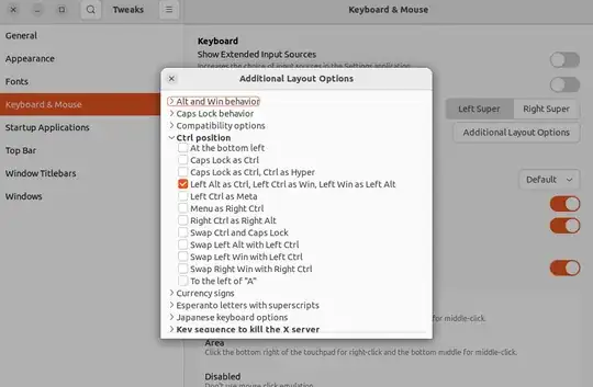

Alternate solution
Using https://wiki.gnome.org/Apps/Tweaks we could configure the desired behavior via GUI.
Afer installing Tweaks, go to "Keyboard & Mouse" and click on "Additional Layouts".
It would open a modal. In this modal, expand the section for "Ctrl position". Here you can see various options to modify the control key position. Select the checkbox that says, "Left Ctrl as Alt, Left Ctrl as Win, Left Win as Left Alt".
This gave the desired results for me.
