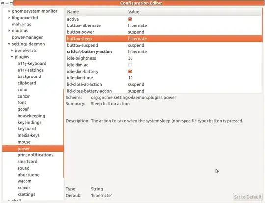

Dconf Editor is the recommend replacment to gconf editor for Unity. You can get dconf in the software center or by typing sudo apt-get install dconf-tools in the terminal.
With Dconf editor, navigate to org gnome settings-daemon plugins power. There you can change what the sleep button does, as well as many other buttons on your keyboard.
