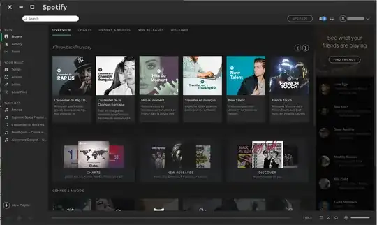

To install the Spotify snap package in all currently supported versions of Ubuntu, open the terminal and type:
sudo snap install spotify
