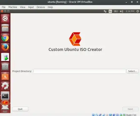

Launch Cubic from the dock or application menu.

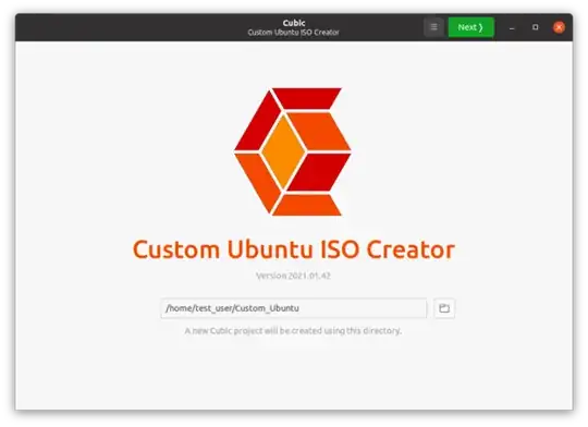

The Start Page
On the Start Page, select a new empty directory to keep all your project files. You can have multiple customization projects, but you must pick a different directory for each project.
The Cubic Start Page

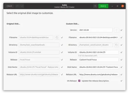

The Project Page
On the Project Page, select an original ISO image to customize. Information on the Project page will be automatically filled out for you. You can accept the recommended defaults. If you chose to change some of the values, the related parameters will automatically be updated as you type.
The Cubic Project Page

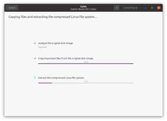

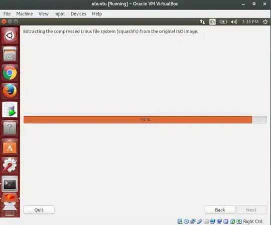

The Extract Page
The next page will display progress as the original ISO is analyzed, important files are copied, and the compressed Linux file system is extracted.
The Cubic Extract Page

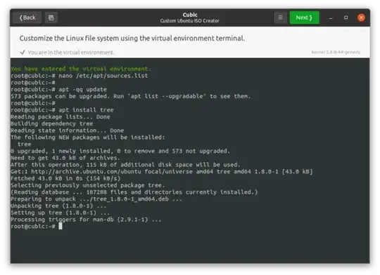

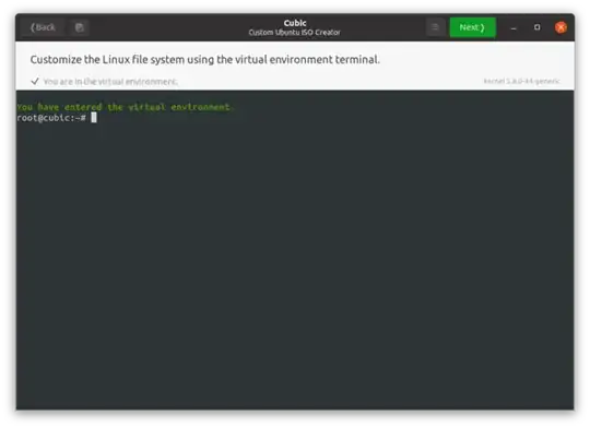

The Terminal Page
The Terminal Page automatically appears once the Linux file system has been extracted. This is a container environment in which you can make customizations using the command line. Since you are logged in as a root user, you do not need to use sudo when typing commands. (You can safely ignore the "couldn't connect to zsys" error messages, or if you do not need zsys, you can execute apt remove zsys to eliminate these messages).
Use command line tools to customize Ubuntu.
The Cubic Terminal Page

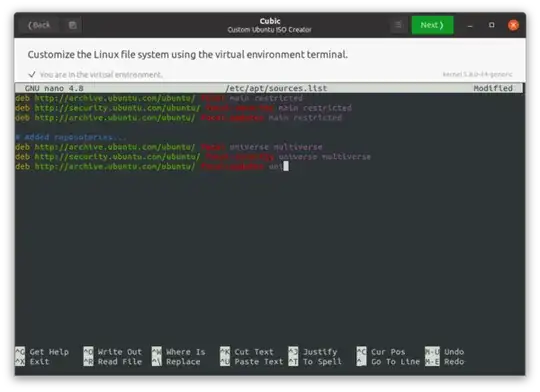

You may use the nano text editor to edit files. For example, to edit the sources repositories list, type
nano /etc/apt/sources.list
To exit nano, type Ctrl-X and you will be prompted to save the file. To not save the file, type N. To save the file, type Y, and press Enter to accept the default file name.
The Cubic Terminal Page with Nano
After editing the sources list, remember to update the list of available packages using:
apt update
You can use apt to update sources and install applications. For example, you can install other Linux kernels.
apt install linux-headers-5.8.0-44-generic linux-image-5.8.0-44-generic

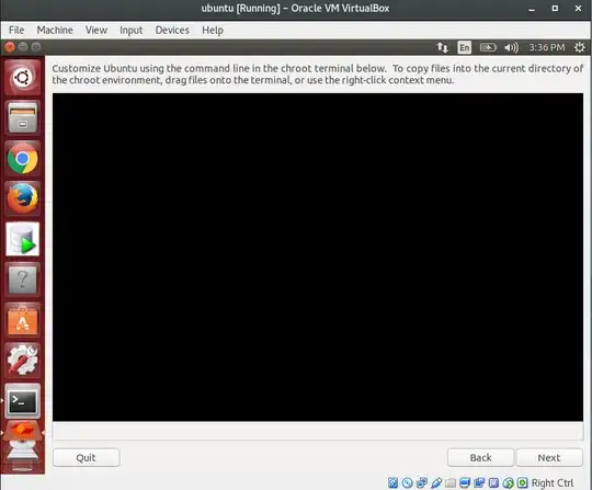

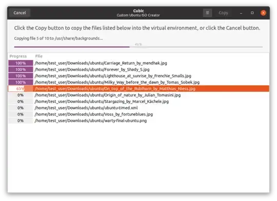

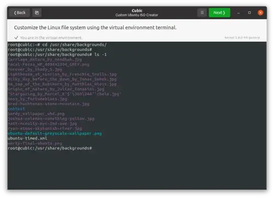

The Copy Files Page
You can copy files or directories into the current directory by dragging them onto the terminal window, by using the copy button in the header bar, or by using the right-click context menu.
The right-click context menu also allows you to copy-and-paste text in the terminal, or you can use Ctrl-Shift-C and Ctrl-Shift-V shortcuts.
Here is an example to copy additional wallpapers into your customized environment.
cd /usr/share/backgrounds
Then simply drag the new wallpapers onto the Cubic window, and click the Copy button on the Copy Page that appears.
Note that the Cubic GUI currently does not support copying files over the network, but you can use the rcp or scp commands from within the terminal environment.
The Cubic Terminal Copy Files Page

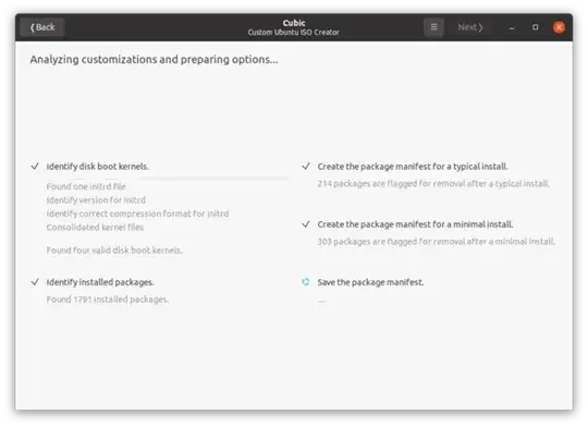

The Prepare Page
On the Prepare Page, Cubic will automatically identify kernels available to boot the custom ISO, and Cubic will create manifest files based on the installed packages. You do not need to do anything on this page.
The Cubic Prepare Page

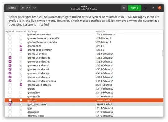

The Packages Page
The Packages Page automatically appears, listing of all packages installed in your customized Linux system. The packages with a check mark next to them are flagged to be automatically removed by the "Ubiquity live CD installer". If you do not want Ubiquity to remove a package after installing your customized Linux system, simply un-check that package.
If your installer supports both Typical and Minimal installs, you will see two columns with check boxes. When you select a package to be removed for a Typical install, the package will automatically be removed for a Minimal install as well.
If your installer does not support Minimal installs, you will only see one column with check boxes for a Typical install.
Be careful when selecting packages for removal, because additional dependent packages may also be removed, and these will not be indicated in the list. Here is an example where gparted was selected to not be removed (i.e. un-checked). However, gparted-common is still flagged to be removed. When the installer encounters this, it will remove gparted-common and gparted will automatically be removed because it depends on gparted-common.
Therefore, it's a good idea to just accept the recommended defaults on this page, unless you know what you are doing.

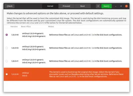

The Options Page - Kernel Tab
The Kernel Tab lists all the kernels available to boot your new Live ISO, including kernels you have installed to your customized Linux system. You can chose to use one of these as the boot kernel for your new Live ISO. It's a good idea to accept the recommended default on this tab.
(Note: On this page you are not selecting the kernel that is used inside your customized Linux system, nor are you selecting the default kernel that will be installed onto a computer by your new Live ISO; instead, this is the kernel that is used to boostrap your new Live ISO).
The ISO Boot files (listed on the Boot Tab) will automatically be updated with your selected kernel files (vmlinuz and initrd). Cubic will also automatically correct file extension (initrd.lz, initrd.gz, etc.) even if the original ISO had the wrong file extension.
The Cubic Options Page Kernel Tab

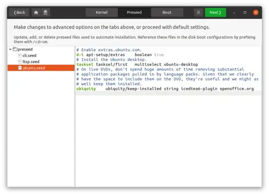

The Options Page - Preseed Tab
The Preseed Tab allows you to optionally create, edit, or delete Preseed files.

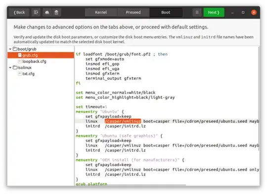

The Options Page - Boot Tab
The Boot Tab allows you to optionally update the boot parameters used while booting the customized Live ISO. These files are automatically updated to reflect the correct kernel files (vmlinuz and initrd). It's a good idea to accept the recommended defaults on this tab.
(Note: On this page you are not updating the Grub boot loader files that are used to boot your customized Linux system; instead, this is the Grub boot loader that is used to boostrap your new Live ISO).
The Cubic Options Page Boot Tab

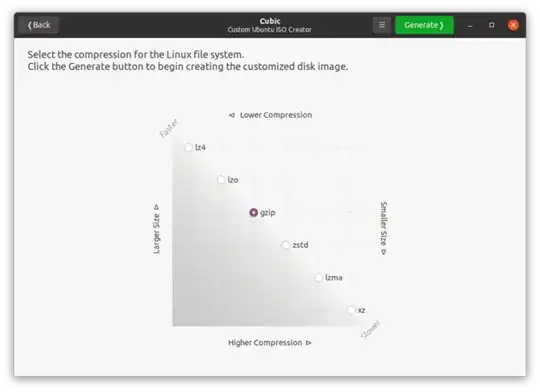

The Compression Page
The Compression Page allows you to select the algorithm used to compress your customized Linux file system (lz4, lzo, gzip, zstd, lzma, or xz).
Algorithms listed towards the top left of the chart are faster, use less CPU resources, but produce larger files. Algorithms listed towards the bottom right of the chart are slower, use more CPU resources, but produce smaller files.
For most users, it is OK to proceed with the default algorithm, gzip.
The Cubic Compression Page

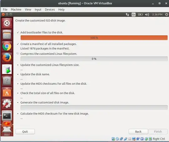

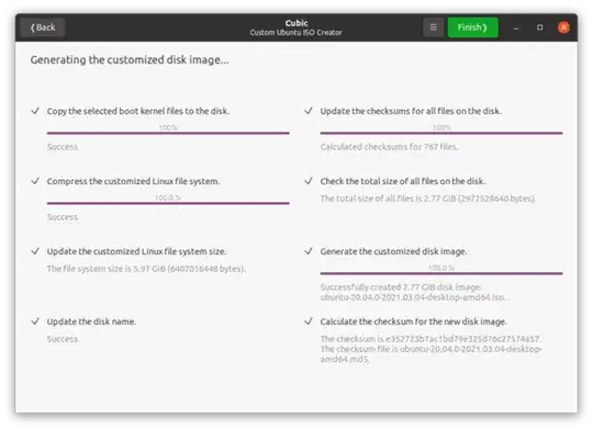

The Generate Page
Click the Next button, and Cubic will automatically package your customizations into a new *.iso disk image. The progress and results of each step are shown. Note that the "Compress the customized Linux filesystem" step may take a long time, depending on the selected algorithm and your system hardware. (You may want to open System Monitor to track your CPU utilization during this step).
At any time during this process, you can click the Back button to immediately go back to the Terminal Page, and make additional changes or customizations you may have overlooked. There is no practical size limit for the generated ISO.
After generating the new customized disk image, Cubic will also generate an MD5 checksum file that can be used to verify your customized *.iso file.
The Cubic Generate Page

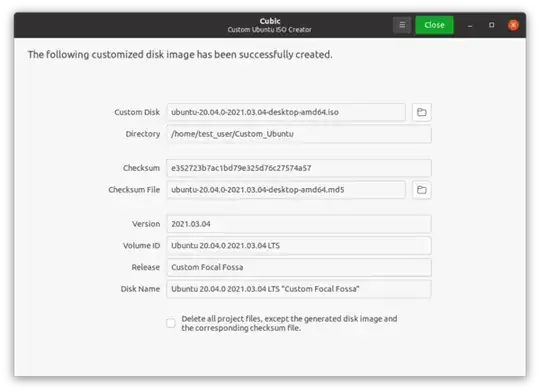

The Finish Page
Click the Finish button, and information about the customized disk image will be displayed.
If you want to delete all working project files (in order to save disk space) check the "Delete all project files..." checkbox. Otherwise, you will be able to continue customizing this project in the future.

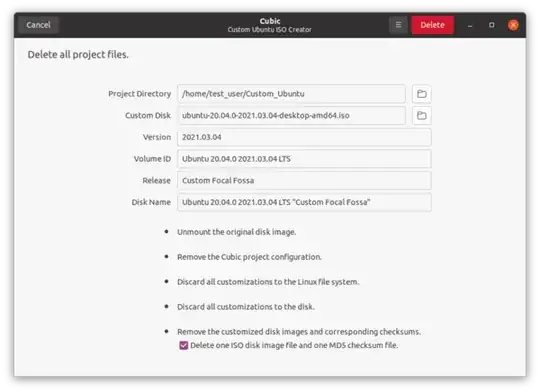

The Delete Project Page
You can also delete an existing project by clicking the Delete button in the header bar. All project working files will be deleted and you will not be able to customize or make additional changes to this project. If you do not want the generated *.iso image and *.md5 files to be deleted uncheck the "Delete..." check box at the bottom of the page.
