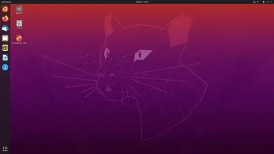

I'm making my own Ubuntu based distribution called Focus OS but I'm confused as to how I am meant to put the "Install Focus OS" program on the Live CD, can someone help me with this please?
Like this but with Install Focus OS on it instead:

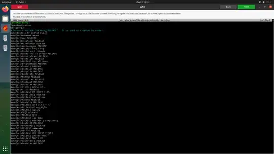

the name is coming from the file
/usr/share/applications/ubiquity.desktop
So edit that file while you are customizing the ISO.
In the image you can notice that, I used CUBIC application to customize the ISO.
