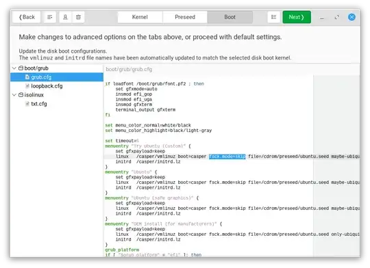

In Cubic, when you get to the Options page, click on the Boot tab and edit the files shown.
For the boot/grub/grub.cfg and boot/grub/loopback.cfg files, create a new menuentry item, such as "Try Ubuntu (Custom)" with the parameter fsck.mode=skip added to the linux line.
For the isolinux/txt.cfg file, create a new label item, such as "live-no-fsck" with the parameter fsck.mode=skip added append line.
For example, in the file boot/grub/grub.cfg:

Here is a screenshot of Cubic's Options page, Boot tab, showing a new menu entry that skips the file system check.
Screenshot of Cubic's Options page, Boot tab
