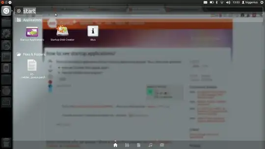

It's normal that you don't see anything listed. The Additional startup programs list is just for programs that start up for the current user (not necessarily for other users, and not all the services that start when Ubuntu boots). Furthermore, it doesn't list the normal parts of the desktop environment that start when the user logs in graphically.
You can check here
Anyone can check this by clicking "Startup applications". Its blank by default.
