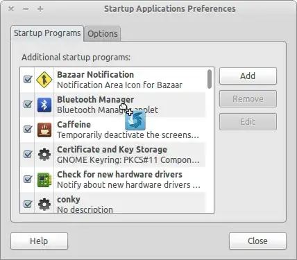

For Ubuntu 10.04, 10.10 and 11.04
You can drag and drop the Shutter menu item (Applications ➜ Accessories ➜ Shutter) into
the Startup Applications window and it will be added to the list of applications that start on login.
