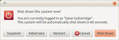

When you press "Shut down", you get a dialog window that comes up with the following options:
shutdown options
However, because I probably restart as much or more than shut down, and I never suspend or hibernate, I'd like to move the "Restart" from the dialog window to the drop down.
Is it possible to place a "restart" option right into the dropdown menu?

This is not possible without rewriting the source code for GNOME Panel. The actions in the menu you're referring to are constructed from this list, which does not include a restart item and isn't extensible using configuration files.
If you're feeling ambitious and want to patch in a restart menu item for yourself, creating a panel_session_manager_request_restart analog of this function would be the place to start.
