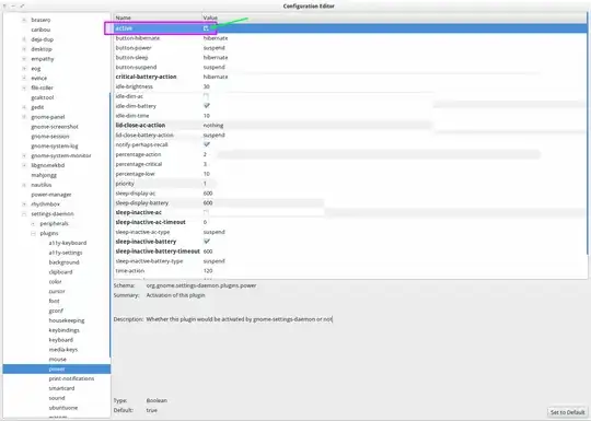

  • Install dconf-editor.
  • Navigate to org.gnome.setting-daemon.plugins.power and untick the active option.
  • Install xfce4-power-manager (sudo apt-get install xfce4-power-manager).
  • Add this to your start up applications.
  • Log out and log back in.
  • You should now see a single battery icon, which will be provided by xfce4-power-manager.
