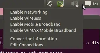

  • I believe this demonstrates the "invisible nm-applet" problem you're experiencing:
    right-click invisible nm-applet
  • Running nm-applet from the terminal gave me this debug information, which leads me to believe that the behavior you see is a side effect of this known bug regarding visibility of the nm-applet indicator in non-Unity environments. The bug has been fixed in Precise, but NOT for Oneiric 11.10.

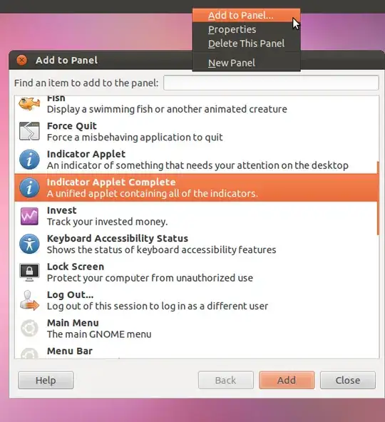

Solution: Do what Precise 12.04 does: use Gnome's indicator-applet-complete!
  • Gnome Classic in 12.04 doesn't have this problem, because it uses a different indicator package that "wraps" nm-applet's functionality (making the bug--fixed or not--irrelevant)
  • As fossfreedom noted in the comments to your question, the indicator-applet-complete package is also available for 11.10 in a PPA. Installing it is your best alternative.
  • To do so, open the terminal and:
    sudo apt-add-repository ppa:jconti/gnome3 -y
    sudo apt-get update
    sudo apt-get install indicator-applet-complete
  • To activate it, let's first remove the existing indicators. Press Win+Alt and carefully right click on the little vertical bar as shown below, and click remove from panel:
  • You'll get an error, just click on Reload -- it won't reappear. Do the same to remove the user indicator from the panel too.
  • Now Alt+ right-click on the empty panel, and click on Add to Panel, which will show you this:
  • Scroll down, select Indicator Applet Complete and click on add, to get the Unity-style indicator bar, including network, sound and user....and that's it!
