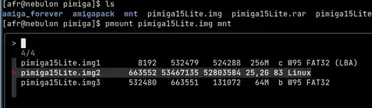

Here's a user-friendly and interactive way that requires that the excellent fzf utility is installed, as well as sudo.
First add this function to your .bashrc or .zshrc:
pmount() { sudo mount -o loop,offset=$(($(sudo fdisk -lu "$1" | sed -n '/^Device/,/^$/p' | tail -n+2 | fzf | sed -E -e 's/[[:blank:]]+/ /g' | cut -d' ' -f2- | sed 's@^[^0-9]*\([0-9]\+\).*@\1@') * 512)) "$1" "$2"; }
Then reload your shell (or type $SHELL).
You can then mount .img files with this command:
pmount my.img /mnt
A list pops up where you can select which permision you wish to mount, using the arrow keys and then pressing return.
Unmount with sudo umount /mnt.
