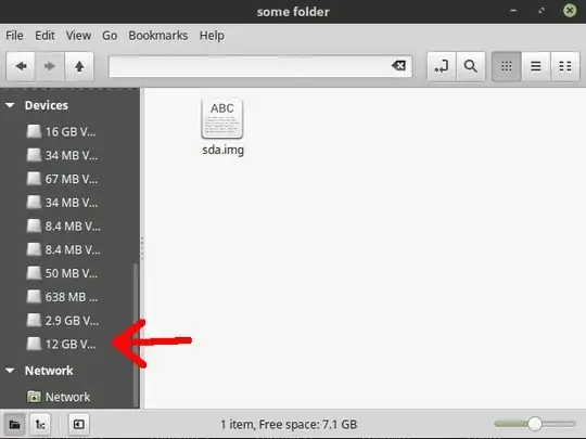

You can also have the computer automatically scan all the partitions in a dump and automatically prepare all loop devices, as described here.
So, lets say you dumped your entire /dev/sda into something called sda.img. You can access its partitions as follows:
losetup -f -P sda.img
On my system, it then shows up as follows:
sda raw image
In non-GUI environments, you can list the created device with losetup -l, which will tell you the name of the loop device, example:
# losetup -l
NAME       SIZELIMIT OFFSET AUTOCLEAR RO BACK-FILE
/dev/loop0         0      0         0  0 /path/mmcblk0
You can then mount say, the first partition, with:
mount /dev/loop0p1 /mnt/mypartition
Hope that helps.
