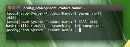

When someone tries to kill the background script:
(action not allowed)

  • Since the script runs on boot up, from rc.local only user(s) with sudo privileges can stop the script, even then only if the user knows the process name.
