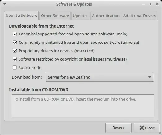

 sudo apt-get autoclean
remove sources.list file.and create new sources.list...
sudo rm /etc/apt/sources.list
Then, type in
sudo software-properties-gtk
enter image description here This will open software-properties-gtk and a newsources.list will be created automatically.
Then change the server to US or to any other server of your choice. You must enable repositories from the new dialog in order to create new sources.list.
Tick all the boxes then click on Revert then click close.
Need to restore default repositories
 sudo apt-get update && sudo apt-get dist-upgrade -y
(it is good practice to backup this file before installing to recover if such things happen)
Now install anything! sudo apt-get install mysql-server
