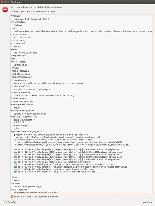

Update
Here is also the error message generated by Ubuntu to be sent to its development community:
