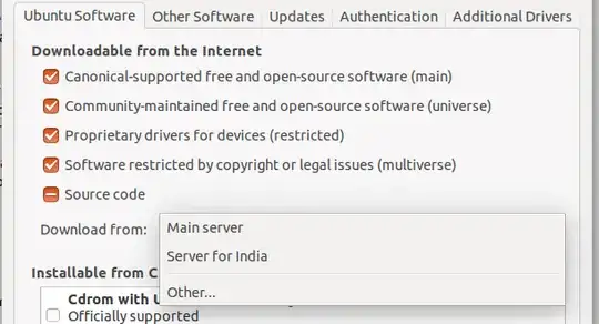

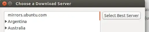

Go to Software & UpdatesUbuntu Software tab → Download fromOther...Select Best Server
screenshot of "Software & Updates"
screenshot of "Choose a Download Server"
