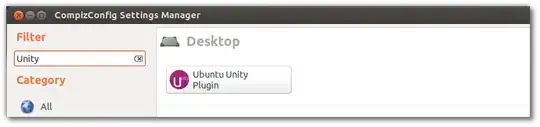

You can change the behavior of the Alt + Tab switcher. There is an option in compizconfig-settings-manager Install compizconfig-settings-manager that lets you group the applications together from the active workspace.
To install CCSM, run the following command in a terminal:
sudo apt-get install compizconfig-settings-manager

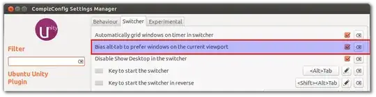

To enable the setting, click on Ubuntu Unity plugin and select Switcher tab and tick Bias alt-tab sorting to prefer windows on the current viewport.
Unity plugin
Switcher option
This will ensure that the applications from the same workspace will get grouped together in the window switcher.
