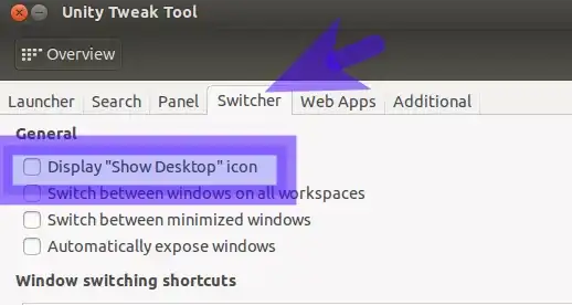

For 13.04, 13.10 and 14.04, to enable or disable the "Show desktop" option in application switcher you can use unity-tweak-tool
Install unity-tweak-tool
pic

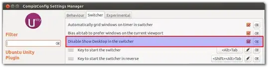

For 12.10, a new setting has been added to CCSM to enable or disable the "Show desktop" option in application switcher.
Run this command in a terminal to install CCSM:
sudo apt-get install compizconfig-settings-manager
Now open CCSM and go to Ubuntu Unity plugin.
Ubuntu Unity plugin
Switch to Switcher tab. Then tick the check box next to Disable Show Desktop in the switcher option.
Disable the show desktop
Tada! No more "Show desktop" in application switcher!.

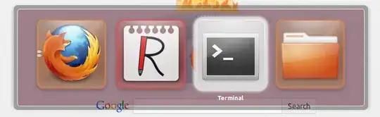

It can be done!
I've uploaded a Unity build for 12.04 that fixes this (no Show Desktop in the Alt-Tab switcher).

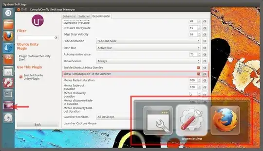

  • You can enable the "Show Desktop Icon" setting in the Unity Plugin in Compiz (using ccsm) to get the icon on the Launcher on the left:

In 14.04, I was able to accomplish this in CompizConfig Settings Manager.
By visiting:
  • "Desktop" section of the listing in the wide, white, right area →
  • "Ubuntu Unity Plugin" item →
  • "Switcher" tab →
  • "Disable Show Desktop in the Switcher" item.
This was a default, uncustomized C.C.S.M. straight from the repos.
