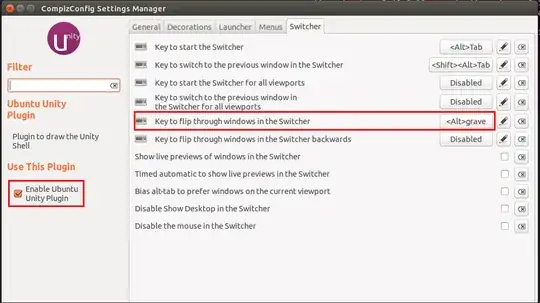

You may also use Alt+~ when you are on a grouped item in the standard Unity switcher to cycle through the grouped windows quickly. When your active window is a terminal that has siblings, you can use Alt+~ directly to switch between the windows of the same application.
You can use the compizconfig-settings-manager from my other answer to configure a different keyboard short cut for this behaviour as well:
CompizConfig Settings Manager
I find that with this additional shortcut it is easier to switch between applications than with the "standard" approach.
