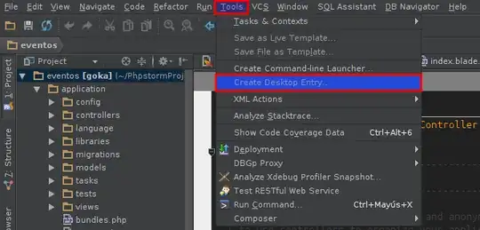

PhpStorm now has a feature to create a launcher for you. It's available under:
Tools -> Create Desktop Entry...
Ubuntu 12, PhpStorm 6 /Tools/Create Desktop Entry...
This will add PhpStorm to the system menu for the current user or for all users. The created launcher is also compatible with Gnome Shell.

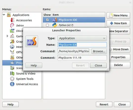

I'm using the gnome-shell in Ubuntu 11.10 and created my launcher for PhpStorm using the same method in Gnome 3 that I would have used in Gnome 2: I used the Main Menu application.
Launcher Properties
The application shows up in search and can be added to Favorites without any hiccups.
