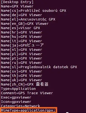

1) Add the new MimeType to the gpxviewer.desktop.
  • sudo nano /usr/share/applications/gpxviewer.desktop
Add the following line:
MimeType=application/gpx;

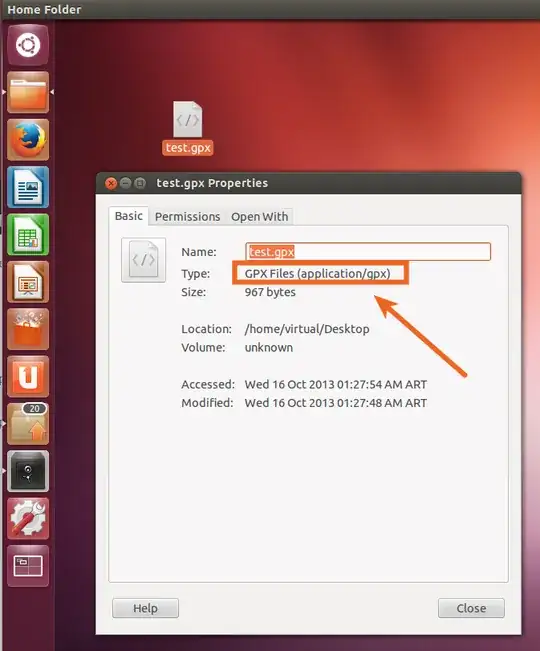

2) Create the new MimeType.
  • sudo nano /usr/share/mime/application/gpx.xml
Add the following to the gpx.xml file:
<?xml version="1.0"?>
<mime-info xmlns='http://www.freedesktop.org/standards/shared-mime-info'>
  <mime-type type="application/gpx">
    <comment>GPX Files</comment>
    <generic-icon name="text-html"/>
    <glob pattern="*.gpx"/>
  </mime-type>
</mime-info>
Save the changes in nano with Ctrl+O, Enter then Ctrl+X.
NOTE: Please change the content of the file according to your needs.
3) Register the Mimetype.
  • sudo xdg-mime install --novendor --mode system /usr/share/mime/application/gpx.xml

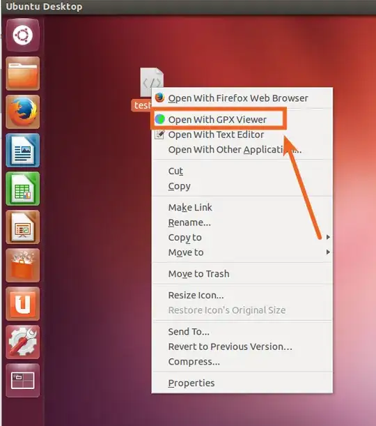

4) Make the gpxviewer application as default to open gpx files.
  • sudo xdg-mime default gpxviewer.desktop application/gpx
5) To see the changes you can Logout & Login or run the following:
  • sudo -i
  • update-mime-database /usr/share/mime
Result:
