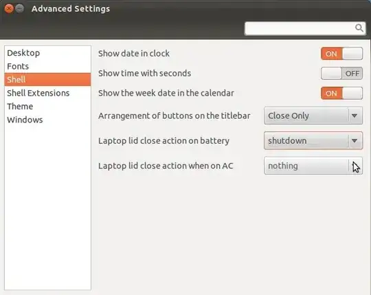

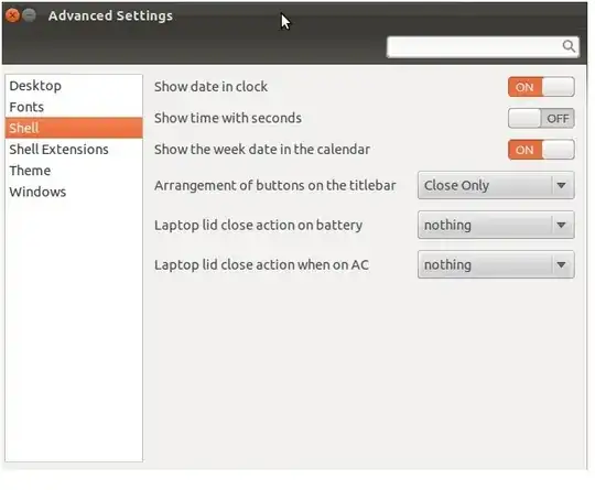

To set up the Laptop Lid Close Action you have to install Advanced Setting (or the Gnome Tweak Tool). It is in the USC (Ubuntu Software Center) under either tweak or Advanced Settings. If installed press the super button and type in tweak or advanced and choose the Advanced Settings. When it opens choose the shell tab;
Advanced Settings Before
Press the arrows and choose you desired on both on AC and on battery;
Advanced Setting After
