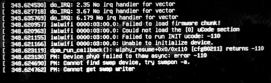

Maybe this has been a terrible idea, since now I get this.
IMG:
In the end I found the question linked above and I went here, but I don't know what to do.

By seeing your last image and EDIT 2, I can understand that Ubuntu can't find a Swap Partition on your system. So I suggest you should create a Swap partition equal to or larger than your RAM size, and try again by running
sudo pm-hibernate
You can create swap partition using GParted, run this to install it
sudo apt-get install gparted
