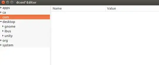

I know the answer here about How do I modify the options for the power button? However, the dconf-editor is completely different than in previous versions. There is no Settings-daemon. It looks like this
How can you change power-button to be Suspend in 16.04?

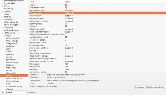

In Dconf editor go to org.gnome.settings-daemon.plugins.powerenter image description here
