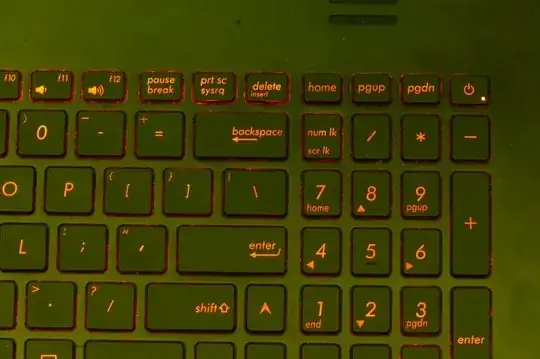

I've bought the ROG G551JM Asus laptop which proven to be Ubuntu-compatible. The computer's keyboard is ill-designed with the key "Poweroff" being an ordinary key, placed in the spot, where one usually finds the "End" key. The computer is fine otherwise, so I bought it with the assumption, that I would be able to somehow "fix" the problem, i.e. remap the PowerOff button into the "End" key.
The PowerOff button made wrong (ASUS G551JM): ASUS G551JM

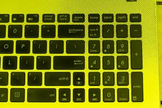

Normally there is an «End» key (ASUS N56VZ): ASUS N56VZ

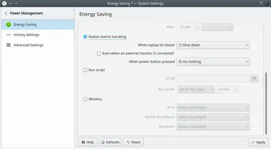

    KDE
    Go to "System Settings", select "Power Management" tab in "Hardware" section and then select "Energy Saving" tab, scroll down, find "When power button pressed" dropdown list and change its value to "Do nothing". Click "Apply" button for changes to take an effect.
    Energy saving
