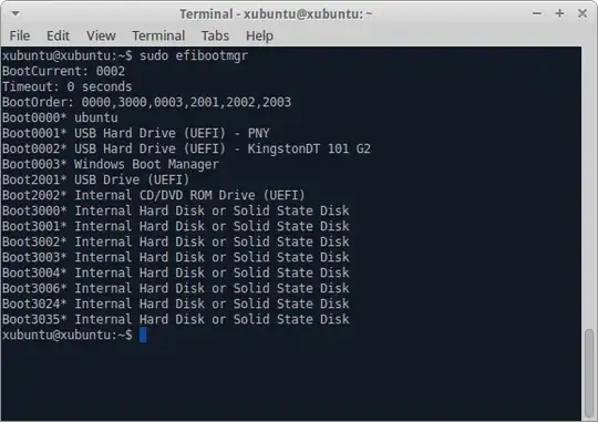

Before installing Ubuntu, we want to make sure that the ghosts of past OS installations aren't going to come back to haunt us in the future. In a UEFI system, operating systems use EFI (extensible firmware interface) files to tell the firmware: "Hey, I exist. This is where you can find me." When a new OS is installed, it adds an entry to the EFI Boot Manager's list, which gives it a unique entry number, and tells the EFI Boot Manager where it's EFI file(s) is/are (Windows registers several different EFI files- one for regular boot, one for a recovery boot, one for Fast Startup- possibly more depending on your firmware and your OS version). The EFI Boot Manager also keeps track of the boot-order: a list of entry numbers that specify what gets booted first. If you've been using EasyBCD; bcdedit; Windows' Boot Repair or Recovery tools; boot-repair in a Linux OS; or even if you've updated Windows or reinstalled it, there's a good chance that your EFI entry list now has some duplicates. At least, that was the case with mine. Having duplicates here can bog down your booting process, as the firmware sifts through the out-of-date or wrong-file entries until it finds a bootloader that works. It can also cause a boot-loop, where bootloader A points the firmware to bootloader B, which points it back to A, and then things start to take a very, very long time...
Anyway, to view your EFI entry list and see what needs to be cleaned, use the efibootmgr package with your live CD/USB. You'll need to install it using sudo apt-get install efibootmgr in a terminal, then run it using sudo efibootmgr. By default, you'll get a list of entries that looks something like this:
When I first used this tool after fiddling with EasyBCD and bcdedit trying to get things to boot in the right order, I had over a hundred entries here, most of them duplicates.
If your boot manager list isn't too cluttered, or if you're not comfortable deciding what can be deleted and what shouldn't be deleted, just skip to step 4.2.
To clean out any entries you don't need, use efibootmgr -b <hex_number> -B, where hex_number is replaced by the number listed with the boot entry. So, to remove the USB Drive (UEFI) entry (numbered Boot2001) in the picture above, I'd use sudo efibootmgr -b 2001 -B. You'll notice that I left some duplicates (all of the 3000+ numbered entries). You can use efibootmgr with different options to view some other attributes of the entries, such as the file paths they point to. Those entries look like duplicates, but they all point to different files used by my HP laptop to update its BIOS. Please be careful what you remove. It can be very difficult or impossible to replace things here. You can also use efibootmgr to change the BootOrder, which it displays. See the man page for more information on this useful tool.

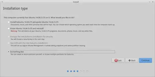

After you've cleaned up the EFI Boot Manager entries, if you chose to do so, it's finally time to install Ubuntu. With your live CD/USB loaded, select the install option from the bootloader menu, or launch it from the desktop after logging in. Choose your options on the first page of the installer. The second part will look something like this: (I'm using Xubuntu 14.04, so your installer may vary, but the options should be pretty similar.)
If your installer doesn't detect your Windows installation (like mine), you'll need to select the "Something else" option. From there, you'll get a screen that looks similar to the gparted menu you used to set up your partitions. Simply select the partitions you made, and assign them to the correct mount point by selecting a partition and clicking "Change".
- If you're installing both OSes from scratch, do the same thing. Do not use the automatic installation option. You need to make sure Ubuntu gets installed in the ext2/ext3/ext4 partition, not the FAT32 Windows partition.
