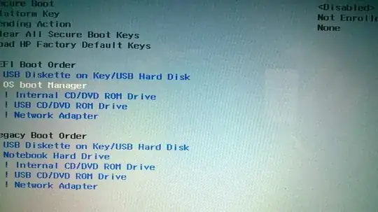

The first picture shows the current UEFI settings. enter image description here

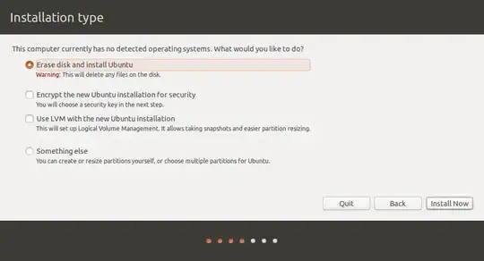

As you can see Ubuntu does not detect Windows 10 and does not even allow me to install it on a different 100 GB partition which I created using the Disk Management utility.
If I choose the option "Something Else" Ubuntu does not "See" the partition that I created on Windows.
So far I have tried disabling secure boot in UEFI and disabling fast start up and shutting it down. enter image description here

First boot in to Windows 10, and open disk management and check whether the partitions are dynamic. Linux cannot be installed on a dynamic disk. (Screenshot would help)
Then check whether you have a EFI partition (vFat) around 100mb. That means you installed Windows in EFI mode.
If the Windows installtion is EFI, then you should also boot your Ubuntu Live Media in EFI mode, if not the legacy bios mode.
Then continue with the Ubuntu installtion as usual.

Some partitions may still to be mounted because Windows seems to be in hibernation mode.
So you first have to boot into Windows and disable hibernation and Fast Boot in Windows.
Open command prompt as administrator and execute :
powercfg /h off
Then open the the old version (not the modern) of Windows Control Panel.
Select Energy Settings - enable show hidden settings - uncheck Fast Boot.
After having done this - shutdown the machine completely - do NOT reboot !
Start the computer and select the UEFI Ubuntu USB drive option to boot from.
Select Try Ubuntu without installing - start the installer - choose Something else.
Install Ubuntu to the unallocated (free) space which you created in Windows before.
After installation is finished, boot into BIOS and select Ubuntu to be the default OS.

  • Most people report that the "Install Alongside" option is absent on EFI-based systems. I don't know the cause. (It could be the hibernation and Fast Startup issues that cl-netbox describes; I've never looked into it.) In any event, you may need to use the "Something Else" option, as described here, among other places.
  • If you get to the "Something Else" option and it shows that the disk is blank (unpartitioned), when in fact you know it contains partitions, then that indicates a problem with the partition table. There can be many causes for this problem, so I'm reluctant to offer advice without more information. Showing the output of sudo parted -l, sudo gdisk -l /dev/sda, sudo sgdisk -v /dev/sda, and sudo fdisk -l /dev/sda may be helpful. Edit your question to provide this information or post it to a pastebin site and post the URL to your output here. (Do not try to cram the output into a comment; it won't fit and the formatting will be lost, making it nearly illegible.)
