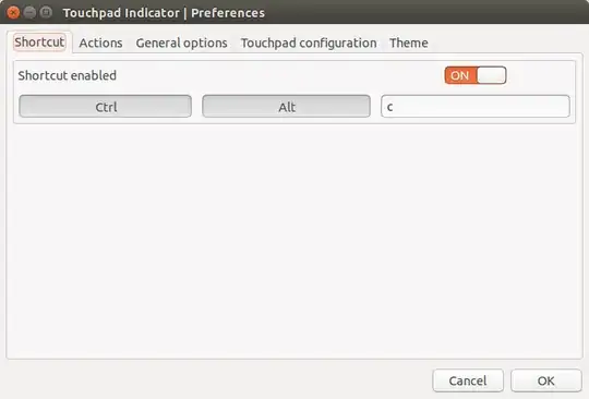

There's a really cool utility called touchpad-indicator which shows an icon in the top bar about the status of the touchpad. The important thing is that it also allows you do to the following:
  • Enable/disable touchpad by simply clicking on the icon.
  • Disable touchpad automatically on startup when touchpad-indicator starts.
  • Disable touchpad when mouse plugged in.
  • Disable touchpad when typing.
  • Enable/disable touchpad using a keyboard shortcut.
I will show you how to install and set it up so that it disables the touchpad on startup.
  1. First we need to install it, open up a terminal and type in the following:
    sudo add-apt-repository ppa:atareao/atareao
    sudo apt-get update
    sudo apt-get install touchpad-indicator
  2. After you have installed it, start it by looking for Touchpad-Indicator in the Dash menu.
  3. You will see a new icon (see picture below) show up at the top right of your screen. Click on it and select Preferences.
    Icon that will show up in the notifications toolbar on the top-right.
  4. You will be presented with this window:
    Touchpad-Indicator tool.
  5. Go to the General Options tab.
    Tabs at the top of application.
  6. Tick the box that says Autostart.
    Autostart checkbox
  7. Now go to the Actions tab.
  8. Tick on the box that says Disable touchpad when Touchpad-Indicator starts.
    Disable touchpad when application starts.
  9. (Optionally) Set any other conditions you like in the Actions tab.
  10. Done.
You can now close that window (by clicking on OK).
Enjoy.

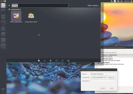

The following command will disable your touchpad, provided that you replace "XX" with the id of your touchpad.
xinput set-int-prop XX "Device Enabled" 8 0
To find your touchpad's id, run:
xinput --list
For instance, my touchpad look like this:
⎜ ↳ AlpsPS/2 ALPS DualPoint TouchPad id=15 [slave pointer (2)]
So my touchpad's id is 15.
So, using this command, I am able to turn my touchpad off:
xinput set-int-prop 15 "Device Enabled" 8 0
And back on:
xinput set-int-prop 15 "Device Enabled" 8 1
This is the same command issued by your enable/disable touchpad hotkey on your keyboard, so you'll still be able to turn the touchpad back on at any time if you need it.
So now, all that's left is to make this command run whenever you turn your computer on. Probably the easiest way to do this this is to add the command to your startup applications. In Unity, just search for Startup Applications in the dash. enter image description hereIf you're using Mate, the tool is under "System -> Preferences -> Personal -> Startup Applications."
Using the startup applications method to run the command, the touchpad will still be active on the login screen and on the profiles of other user accounts. If you want to make the command run system-wide during startup, this question has some helpful answers to get you started.
