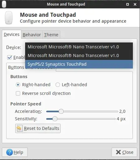

In Xubuntu 14.04. accessing the settings to disable and enable the touchpad are a bit hidden - in Settings-Mouse and Touchpad, and once there, there are a few other clicks needed.

  • setting advanced properties like in the image below
(namely 'show last used item' and 'inside button'),
  • and adding two specific icons,
the launcher will always display the current status of the touchpad.
