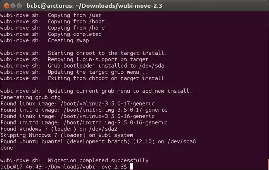

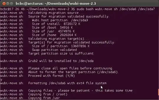

Please refer to: https://help.ubuntu.com/community/MigrateWubi
This above Wiki has a downloadable bash script that migrates a Wubi install to a partition. It also has a link to the manual instructions required to migrate a Wubi install, although these are not recommended because the script contains many additional safety checks. The script does the following:
  1. Checks the current install being migrated e.g. Wubi?, size?, type of grub?
  2. Checks the target partition(s) and swap if included. The target partitions must be type '83 - Linux', empty and large enough to hold the install being migrated.
  3. Provides feedback to the user of any errors, or notifies the user what changes the script will make and asks the user whether or not they wish to proceed.
  4. Formats the target partition(s), copies the current install to the new migrated install.
  5. Updates the /etc/fstab and enables hibernation (see README notes)
  6. Chroots to the migrated install, removes lupin-support, then generates the grub menu (grub.cfg) and installs the grub2 bootloader if requested. For grub-legacy migrations it replaces grub-legacy with grub2 (on the migrated install only)
  7. Exits chroot, and updates the current installs grub menu to include the migrated install.

Usage: sudo bash wubi-move.sh [OPTION] target_partition [swap_partition]
   e.g. sudo bash wubi-move.sh /dev/sda5 /dev/sda6

The source for the script is maintained here: https://github.com/bcbc/Wubi-move Releases are tagged and Issues can be raised if required.
Note: the script can be run from a live environment, e.g. to replace Windows, although it is simpler to manually partition and run it directly from the Wubi install (in my opinion). There are some more screenshots of the script (using the previous release) here that show how to migrate using a root.disk or to separate partitions.
