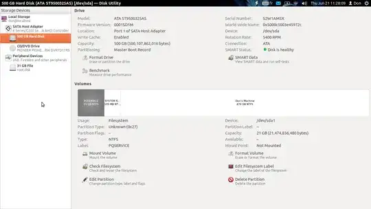

So yesterday I got it in my head to look at my partitions (I was considering making an all new partition to install the Windows 8 Release Preview). What I saw confused me. Here's a screenshot of the disk utility. At this moment, there is nothing connected to my computer, and nothing in any of the optical drives/ports/card readers/etc.
Disk Utility Screenshot
Can you help me figure out what's going on here?
Don's Machine is, I believe, my Windows partition - that's the name I assigned my machine from Windows Explorer.
PQSERVICE is from what I can find online also Windows, but having to do with backup.
And SYSTEM REQUIRED, if I browse it in Ubuntu, is definitely something to do with booting, and I believe it is also Windows'. According to the sizes shown, those three together should use up my 500 GB HD.
Then further down, as a "peripheral device", it lists that 31 GB disk. This is obviously my Ubuntu (Model:Linux Loop:root.disk), but why is it showing up as a peripheral?
So, to sum up those questions and to add some more random ones I had:
  • Why is Ubuntu showing up as a peripheral device?
  • If the Windows sections take up all 500 GB, where does Ubuntu live?
  • If I renamed the disk partitions, would my life become a nightmare (seriously - can I safely rename them)?
  • Why didn't I have to resize the Windows partition in the first place?
  • Would giving Ubuntu more space improve its performance (it hangs alot)?
  • Is it possible to have a partition for each OS (Windows 7 & 8, Ubuntu), a partition for files, and a separate partition for backups? Is this towards the good or bad idea end of the spectrum?

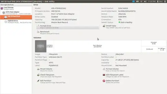

@Takkat: Rather than bother with converting it to a true install, which many things I read said would be difficult, I decided to just back up my small amount of data, erase it, and redo it the right way. Now I have something a little more in keeping with what I would expect from a dual boot, and every time I start up, I see a purple GRUB screen. Success I think. Second Screenshot of Disk Utility (I successfully created the partition without problem or data loss, but wasn't paying attention and installed 32 bit Ubuntu on a 64 bit system. Didn't work well. Fixed the MBR, uninstalled Linux, and installed the RIGHT Ubuntu).
  • So can I rename these partitions?
  • I set up a 50GB partition. How come the partition is 54 GB, and Ubuntu only took 4?
It seems you installed Ubuntu with the Windows Installer (Wubi). This means that your Ubuntu installation resides in a file on your Windows (NTFS) partition (look for C:\ubuntu\disks\root.disk). This file will be mounted as a loop device on booting into Ubuntu. This is the "peripheral device" you noticed.
It is therefore likely not the dual-boot setup you intended to do. But, as you already mentioned, if everything works fine you may leave it like that. You can always migrate this installation to a regular installation later:
How to convert Wubi install into regular install?
