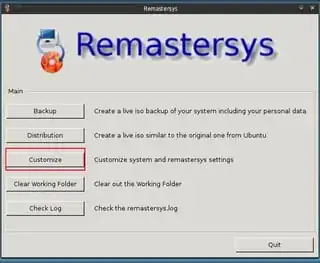

If you wanted an alternate solution to using the script provided in the comments, remastersys might be a good option. Wubi installs are small (remastersys won't work if the image it creates is more than 4gb). I'd install remastersys as per the instructions on their webpage in the wubi install. I would however change the working directory to somewhere on a larger partition, such as your windows partition
To do that select customise

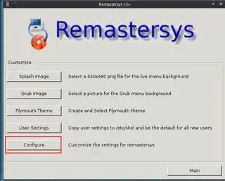

then configure

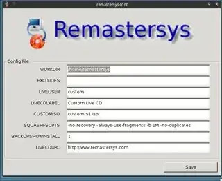

then change the workdir
Once thats done go back to the main screen and hit backup - this will generate an ISO in your workdir. Burn or use wubi to boot, then install as per normal
