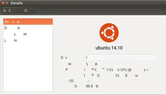

I have a fresh installation of Ubuntu 14.10 on my laptop. It appears that letters are missing from files and folders, as well as menus and configuration windows. I'm not sure where to start in order to fix this.

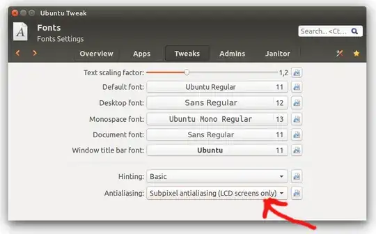

Then, go to Fonts, change Antialiasing option from Subpixels Antialiasing (LCD screens only) to Standard Grayscale Aliasing and everything seems to work fine. In fact, the problem immediately appears/disappears on changing the setting, so seems this is indeed the possible cause.

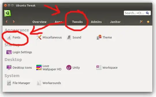

Graphical Guide — Ubuntu Tweak tool
With missing letters, you might have trouble finding the "Antialiasing" label etc. Here's a graphical guide on how the tool looks with working fonts, to help you find where to click.
In the first window, you must pick the "Tweaks" tab in the top row (third from the left — i.e. the central one), then "Fonts" (first icon on the left in the first row):
Ubuntu Tweak -> Tweaks -> Fonts
Then, click the bottom choice bar, and choose the middle option (I can't show a screenshot with the choice bar opened, unfortunately, as Ubuntu doesn't seem to react to me pressing the PrtScr key then :-/)
Antialiasing choice bar

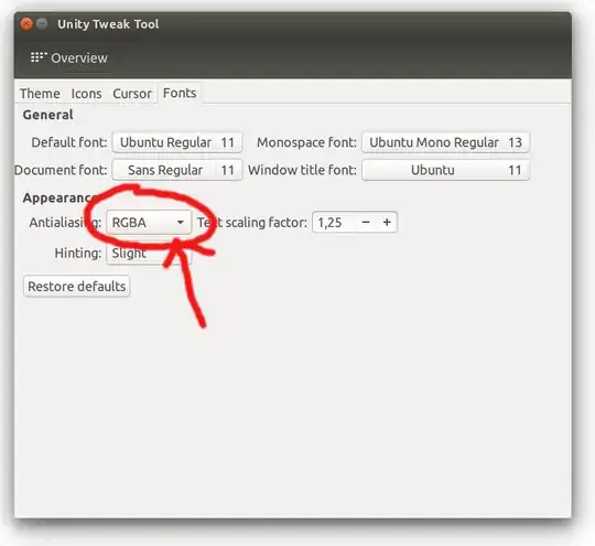

Graphical Guide — Unity Tweak tool
Similar guide as above, but for the Unity Tweak tool.
After starting the tool, click "Fonts" (right-most icon in the third row):
Unity Tweak -> Fonts
Then click the marked choice bar, and select the middle option when it opens:
Fonts -> Appearance -> Antialiasing

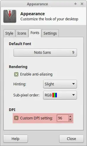

With XFCE I had the same issue. Fixed after disabled DPI font resolution:
