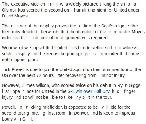

Actually, check this out:
Before typing more: enter image description here
After typing more: enter image description here

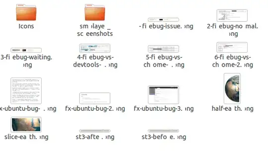

This is a system-wide problem, some screenshots from Firefox, Nautilus, etc:

I have seen similar problems with 14.04. They seemed to be fixed in 14.10, and even better in 15.04 (this latter, specifically regarding nVidia cards). So upgrading will probably be worth a try.
The underlying problem seems to be a bug within Unity itself. I have not encountered anything like it on XFCE, KDE or Cinnamon. If you do not wish to install a full system (maybe on a second partition?), you could try one of these desktop managers, see if it plays better with your graphics card.
HTH.
