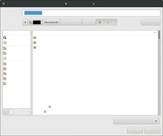

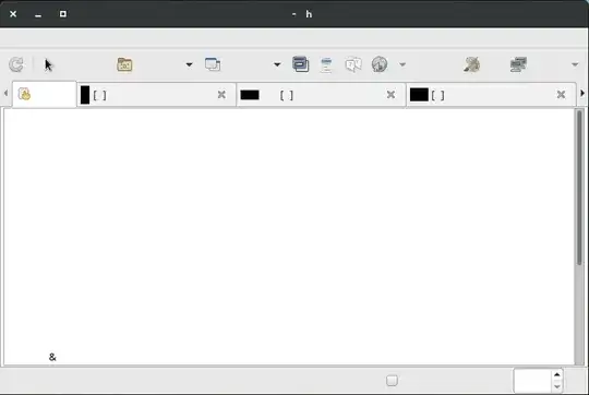

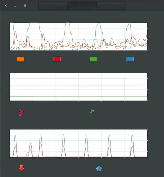

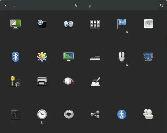

I find that often after awakening from suspend on Ubuntu GNOME 16.04 with GNOME 3.20 (I have only found this issue on the latest version, though I have not tried with GNOME 3.18 on 16.04) that I get this strange font issue which can't be fixed by restarting gnome-shell and seemingly only by restarting my entire machine:
gnome-system-monitor font issue
Shutter font issue
File Chooser font issue
Title Bar font issue
gnome-control-center font issue
I do not believe that this is a theme issue as I have tried all the built-in themes (including the dark and light versions) and it is the same for them all. Though it does not seem to affect gnome-shell areas, that is the top-bar, the Activities Overview, etc, are not affected for some reason. So what could this issue be caused by and how can I fix or workaround it?

This might be symptom of a kernel bug since 4.4.6, see here which reportedly got fixed in Linux kernel 4.8.x, and the fix will be in Ubuntu 17.04 (which will likely have 4.10 kernel).
On Fedora bug tracker, someone reported that changing / adding this in /etc/X11/xorg.conf.d/20-intel.conf helps:
Section "Device"
   Identifier  "Intel Graphics"
   Driver      "intel"
   Option      "AccelMethod"  "blt"
   Option      "TearFree"     "true"
EndSection
Didn't try, I am going to wait for 17.04.
To me, this happens also after switching to another user account and back.
When my Ubuntu has display problems when recovering from suspend, I fix it with a quick visit to console: Ctrl+Alt+F1.
Wait a couple of seconds if your display blinks, changes resolution etc. Then back: Ctrl+Alt+F7.

Workaround, use kernel 4.8:
sudo apt install linux-generic-hwe-16.04
https://bugs.launchpad.net/ubuntu/+source/xserver-xorg-video-intel/+bug/1573959
mr.xkr
I had this problem and discovered that for some reason my laptop was using an old kernel version (4.4, rather than 4.15, currently) .I'm on 18.04, having upgraded from 16.04.
I installed the latest kernel:
sudo apt-get install linux-image-generic
That has fixed the issue.
