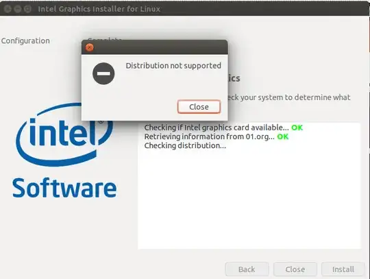

My processor is Intel core i3 inside x64 bit and RAM is 4 gb. When I used Windows 7 Intel was successfully installing, but now I am using Ubuntu 14.04 and Intel Installer makes me crazy!!! I've tried to change lsb-release, but is doesn't help me. I tried to reinstall signature and Intel Installer, but everything is the same!
I heard this problem was on Ubuntu 14.10, but not on Ubuntu 14.04.1 LTS. If someone knows why I have this error please help me...

NOTE (updated 18 March 2015 09:15 UTC-7): This release of the Graphics Installer requires Ubuntu 14.10 "utopic". The Graphics Installer will not function on Ubuntu 14.04 "trusty" and support is deprecated (see this forum announcement and this explanation).The Intel Graphics Installer for Linux

Because the installer could not work with 14.04.2 (HWE) or if a 14.04.1 user of the installer tried to install the lts-utopic mesa stack they've dropped any further support for 14.04.x
Read here for announcement - https://01.org/linuxgraphics/node/471
Personally don't think the Intel installer provided anything of real value, at least here with Haswell (mobile)
Updates for libva & vaapi are available from several ppa's, search if interested there.

This is how I managed to install Intel Linux graphics driver:
For Ubuntu 14.04 with kernel linux-image-3.16.0-30:
  1. Install kernel If not yet installed:
    sudo apt-get linux-image-3.16.0-30-generic linux-image-extra-3.16.0-30-generic linux-headers-3.16.0-30-generic
  2. Remove old kernels, e.g.:
    sudo apt-get purge linux-image-3.13.0-24-generic linux-image-extra-3.13.0-24-generic linux-headers-3.13.0-24 linux-headers-3.13.0-24-generic
  3. Add Intel Linux graphics repo:
    sudo sh -c 'echo "deb https://download.01.org/gfx/ubuntu/14.04/main trusty main #intel-linux-graphics-installer" > /etc/apt/sources.list.d/intellinuxgraphics.list'
    wget --no-check-certificate https://download.01.org/gfx/RPM-GPG-KEY-ilg -O - | sudo apt-key add -
    sudo apt-get update
  4. Install driver:
    sudo apt-get install --reinstall i915-3.16-3.13-dkms xserver-xorg-video-intel i965-va-driver intel-gpu-tools
    Next step might be unnecessary if backlight change works for you:
  5. Add kernel param: acpi_osi=Linux instead of: acpi_osi=Linux acpi_backlight=vendor to linux line in /boot/grub/grub.cfg via grub-customizer.
  6. Create file /etc/X11/xorg.conf.d/20-intel.conf with content:
    Section "Device"
            Identifier "card0"
            Driver "Intel"
            Option "Backlight" "intel_backlight"
            BusID "PCI:0:2:0"
    EndSection
  7. Update initramfs:
    sudo update-initramfs -u -k all
And it works after reboot.
