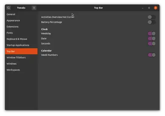

Download and open gnome-tweaks, go to the "Top Bar" tab and disable the "Activities Overview Hot Corner" setting:

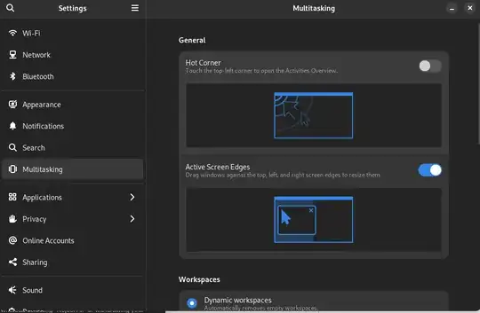

14 years old question (and counting), but still shows up early in the typical google search, so for Gnome on Debian 12 I found the setting here:
No extension required.
