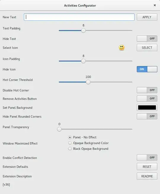

Using the Activities Configuration. You can disable the hot corner and there are plenty of other settings.

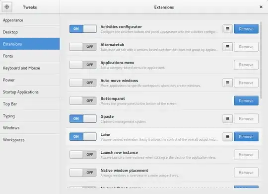

Open the URL via Firefox browser to install the extension directly.
After that, open the Tweak Tool for the configuration
A.B.
