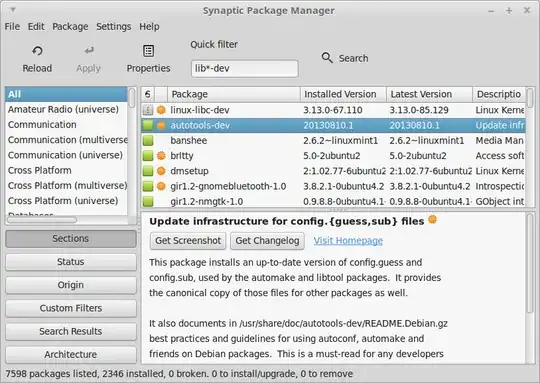

Use the synaptic-package-manager:
synaptic Package Manager (GUI)
Assuming that we'd like to locate the files of the autotools-dev package, under 'Quick filter' enter autotools to locate it. The autotools-dev package appears automatically. Select it by clicking on it and then press 'Properties'. In the appearing dialog select the tab 'Installed Files'.
