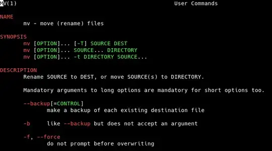

Beside less there are other pagers available: pg, most and w3m just to list three. I recommend most: It comes with a very useful coloring of key words making a man page much easier to read and navigate, see for yourself:
most screenshot displaying mv's manpage

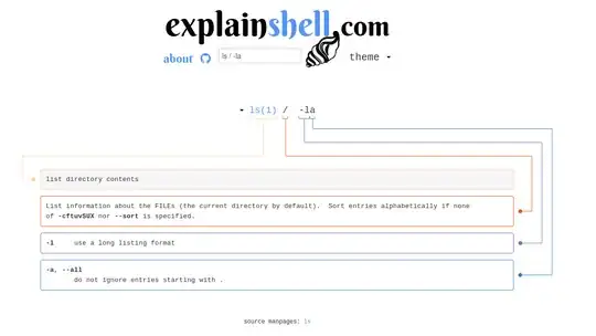

The basics have been covered already, but one website I think is quite helpful for telling you what a command does is https://explainshell.com, which breaks down a command into its sections and shows what each bit does.

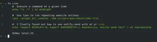

My favorite is commandlinefu.com, have a function in your .bashrc or .zshrc like this
cmd() { curl "http://www.commandlinefu.com/commands/matching/$(echo "$@" \
    | sed 's/ /-/g')/$(echo -n $@ | base64)/plaintext" ;}
Let's try cmd mount cd, I called my function cmd, you can call it whatever you want
The function above searches commandlinefu's website, it's a community driven website much like here, users have the ability to upvote commands and so on. Then it shows the top results as in the picture.
or there's a new way to do that by using this.
http://samirahmed.github.io/fu/
Here's a tutorial.
Let's do fu cron
