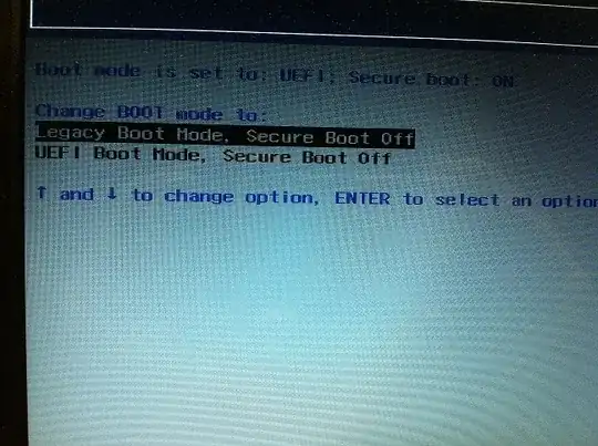

In boot mode settings I had 2 choices:
  • Legacy Boot Mode, Secure Boot Off
  • UEFI Boot Mode, Secure Boot Off
As in the picture:
boot_mode_settings
Choosing the first one, allowed me to boot from the CD and log into Ubuntu (Trial mode). There, in the terminal, I typed the above commands and on the 3rd one I got:

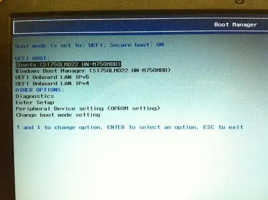

Finally, I went back to Boot Manager to check if the problem is solved, and, unexpectedly, I found 1 ubuntu entry:
boot_manager_2

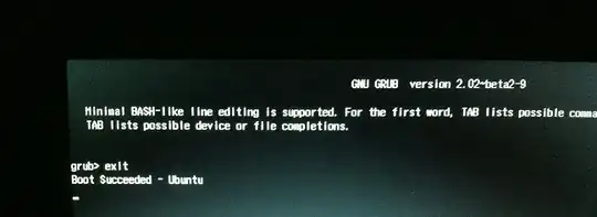

I tried booting again from the CD using UEFI but I couldn't; I got right into the grub>. So I typed exit, and it returned me back to Boot Manager:
grub
So why wasn't that entry removed although I removed it? And how do I really remove it?
